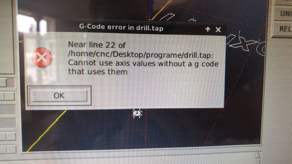

When generating a drill cycle in Fusion 360, LinuxCNC suddenly stops and gives me a "cannot use axis values without a g code that uses them" error.
The code looks like this:
(3004_DRILL_3.5MM)
(T2 D=3.5 CR=0. TAPER=118DEG - ZMIN=-4.052 - DRILL)
G90 G94 G91.1 G40 G49 G17
G21
(DRILL3)
M5
M9
T2 M6
S2000 M3
G54
M9
G0 X108.02 Y4.3
Z25.
G98 G81 X108.02 Y4.3 Z-3.052 R25. F10.
G80
X68.8 Y17.884 Z25.
Z24.
G81 X68.8 Y17.884 Z-4.052 R24. F10.
Y42.884
G80
Z25.
G81 X108.02 Y67.38 Z-3.052 R25. F10.
X4.3
Y4.3
G80
Z15.
M9
M30
The problem is that it cancels the G81 cycle with the G80 command and then tries to move the axis without setting the correct G0/G1 for movement, so LinuxCNC does not know what to do with the axis values it is fed.

Have your post been edited or is this the stock one that comes with Fusion?
Looking at the code, whenever a G80 occurs the gMotionModal is reset.  This means that for the next move a G0-G3 should be generated.
function onCycleEnd() {
  if (!cycleExpanded) {
    writeBlock(gCycleModal.format(80));
    gMotionModal.reset();
There is only one place in the post that I see where an axis move is created without a gMotionModal first occuring and that is within a cycle after the first move...
Are you able to share your model here so this can be recreated to better help troubleshoot?

It wasn't adding a g0 or g1 command after g80, but i have added
at the end of
onCycleEnd()
function and now it works.
Thanks!

Bump to an old topic but this worked for me also. Thank you or the help. I added it to the last line of "function onCycleEnd()"
at the end of
onCycleEnd()
