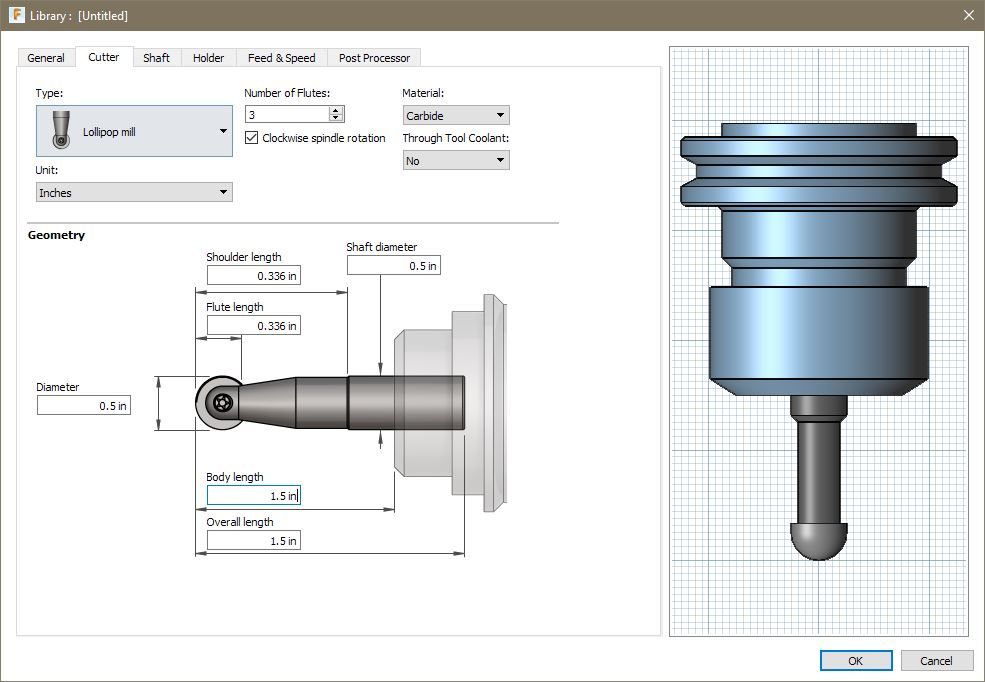

Is there any way to create an endmill with custom dimensions?  I have been able to create a form mill with the desired geometry, but can't use it as an endmill... "invalid tool type for milling".  Can your CAM developers add a 'shoulder diameter' option to the lollipop or slot mill?  I am trying to undercut a tapered wall with a lollipop mill and the clearances are pretty tight.  Would love to be able to accurately model the tool for simulation purposes.  Once a form mill is created, is there any way to trick Fusion into treating it as an endmill?

Have you tried adding Shaft sections? Can you link the tool here so we can see what you're trying to create?

Thank you Neal...  Here is a link to the tool... http://www.harveytool.com/ToolTechInfo.aspx?ToolNumber=22832-C3
The picture shown is generic and doesn't represent the actual tool geometry.  I have attached a sketch with the dimensions.
I hadn't tried adding shaft sections until I read your reply... I have since tried adding a shaft and I am thoroughly confused on exactly how that works.

Here's how I have it set up:
Unfortunately this still doesn't actually show up as a true lollipop mill with the ability to undercut. I'm not sure why, but perhaps @fonsecr or @cj.abraham could chime in? I know it's doable, as I have done it before, but I suspect something in the representation isn't working correctly.
Edit: I just noticed your definition thinks your tool is 0" in diameter. Try changing that to .5" and see if it will let you use the form tool then. I believe you've confused the CAM Smiley Wink

@Steinwerks To address your tool definition question, it looks like the shaft diameter of 0.5" and a lollipop diameter of 0.5" is creating a ball endmill. Try making the shaft diameter on the cutter tab smaller and then adjust the shaft segments accordingly.
