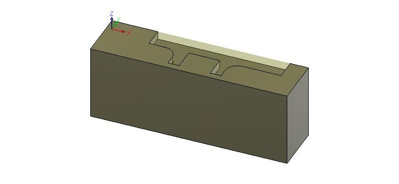

I just had an instance where I could not copy and past a 2D Adaptive op to a different file? I created a set of soft jaws for a job, machined it to check it would fit the part. Then I flipped the soft jaws drawing, did my stock set up but I could not copy and paste the 3 machining ops to make the second half/part? Same tool #s, same stock size, same 0,0 original location. It was only after I made a new 2D Adaptive op on the mirrored part could I copy and past from the 1st part? Is this normal?

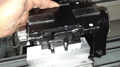

I will try as soon as I can. Got the soft jaws machined and machined the magneto base that this whole issue came from!  The magneto was repaired by someone else but they neglected to machine any mounting holes!
