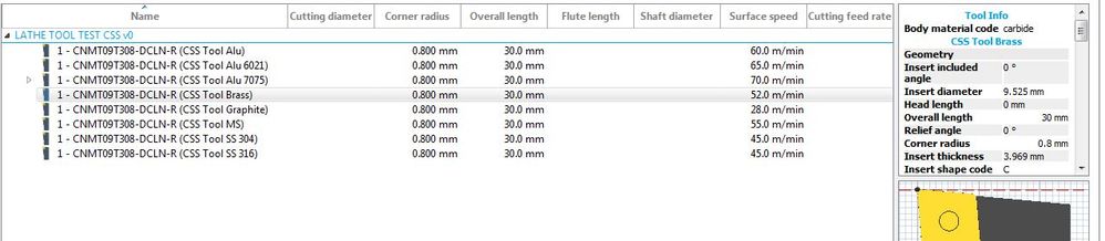

engineguy
@andrew.todd1
@iporter6
@christopher.cooperVHK2N
@Ketherton21
Having looked at all the responses I have to go with what Vic @Anonymous  posted, he is spot on.
Why would you want a different default when you have to change it anyway depending as Vic rightly says on material/tooling/type of workholding/tailstock or not etc, etc any of the foregoing will require a change of that value and as it is already defaulted to the machine maximum rpm (That is what 0rpm value will do) and the maximum rpm field G50 is simply an override of the machines maximum rpm, as the machine max value is usually set in either the machine control (Parameter) or in the Post Processor or both where a value can be set so that no matter what value is input in your turning operation the PP will not output a higher value in your G code, for example if set at say 3000rpm and the user sets a value of 4000rpm either by accident or design the PP will only output S3000rpm in the code, yes, super safety built in.
The settings for the tool are either for use with CSS or without it so even if you were to say create two identical tools one set for CSS and one set for no CSS you will still get the default value of 0rpm for the CSS one and whatever you set for the default for the non CSS tool which you would probably need to change anyway!
Here is some code with no CSS, it does show a G50 value of S4000 rpm which is showing what is set as max rpm in the PP, lower down in the code the G97 S3500 shows what was set in the operation with the CSS unchecked.

Again it shows the G50 S4000 max rpm at the top and lower down it now shows the value input at the operation for the max rpm and the CSS setting.
So, with those tools saved in a tool library whenever you start a new a new job you can either select any of your pre-set tools from that location and they will be put into the library created for the new job and you will get the same values as the previous job, that`s about as close as you will get it for now, it works fine and the values can all be adjusted in the operation as needed but will not change the tool settings in the tool library.
Seems to work fine for me anyway, all very easy once setup, anyone has a better "workaround" I would love to hear it 🙂 🙂

Back to the subject matter, the Lathe system does indeed require much modification on the Spindle Speed side of things, for example if you toggle between CSS on/off in an operation it throws up a default of 200SF and 5000rpm, where that is hidden in Fusion I have no idea, that needs clearing out for starters, I would be in favour of a 0 (Zero rpm) value rather than the 0 (No override) that we currently have and just fill in the spindle speed for that operation, easy and safe.
We also have settings at the Tool level and for me that tied to the 0 Zero rpm default setting in any/all operations is probably the best way forward. What I have done for a workaround is create Tools for Materials in a simplified way so starting a job we always know what the material will be, very often the same tool holder will be used but with the insert changed to suit the material/operation, this is something that has to be done before we do anything else.
We know or should know what speeds and feeds we can use with a specific insert/material combination so it is easy to set up tools to suit, in the image below you will see my little CSS tool library that allows me to select the right tool for the material/job every time, in the example I am doing some Brass so the tool for Brass is selected and a spindle speed that should be somewhere near is input, after that the spindle speed can be adjusted to find the "sweet spot" for that particular lump of stock using the machine control override, probably have to change it slightly between different batches of stock, happens every day and the system works great, pick the tool for the job, check it has the correct insert in it, check and re-set length offset if needed and put a spindle speed in, can`t get any easier than that 🙂
The Surface speed figures are arbitrary until a couple of jobs have been run and those numbers "tweaked" until we have a full loaded library that is very easy to use, a different Non CSS Library with all the same tools in it will have all the pretty near correct spindle speeds.
Takes a bit of work but it is something that is easily built up over time 🙂 🙂

I don't have a tool library to this date that has any parameters preset to my preference, I program every job with tool data dialed in for what I intend to do at the time and on that job.
I have small selection of custom ID tools, mainly because I don't want to create new custom tool every time I need one but speeds and feeds are subject to change without notice.
I am not in favor of including spindle speed in tool data for lathe work for all the reasons mentioned.
As stock grows larger and heavier, RPM's play role in ability of chucking pressure to hold stock and it is up to machinist to determine where the limit is. From that perspective you would want to start conservative and adjust upwards as you see fit rather then start high and adjust downward before it causes disaster.
If initial max RPM is set at zero, you will have to set some value to first tool in use and that will be in effect until you assign another value to different operation, something I find to be necessary anyway due to numerous factors and conditions effecting desired result or requirements.
Message 18 of 20
On certain Mori Seiki models of lathes rapid traverse is forced to 25% if door is open.
On new Hunday Wia lathe I was unable to index turret unless door is closed and turret is homed in X axis, turret stroke limit in Z axis was set to 2 inches in front of chuck.
On Haas lathe you cannot do certain things during setup unless chuck is closed,........ with nothing in jaws.
There is certainly something weird going on with perception of safety among machine tool builders.
Bad things happen in matter of seconds and so example of forcing rapid traverse speed down is beneficial and good idea.
Having to close door and home turret to index it is annoyance, there is usable thickness of jaws I can't trim with turret soft limit set to 2 inches away from chuck.
I don't want to home turret and close door dozens of time to index turret and setup a job.
Door will protect you from coolant, chips and small objects, not much else.
So, door lock is disengaged and permanently attached to switch, soft limit set to 1/4" in front of chuck, don't have to home turret to index it and now I can get things done.
If anyone else attempts to run the machine, their confidence and awareness level may require setting things back to factory settings but that is not factor in my case.
Max spindle speed is 3500 RPM, I don't want it to wind up to that limit by chance, by accident, by being default output in Fusion, in post or by any other means, because right speed heavily depends on what is in the jaws at any time.
If in favor of having max spindle speed set in setup or tool library, make it 500 rpm, gets things moving in conservative and safe manor, then change it to anything your particular need calls for in following operations.
By having to change it, you eliminate chance of overlooking it if range is too high for given task, especially if you are passing program onto another person for prove-out and setup.
