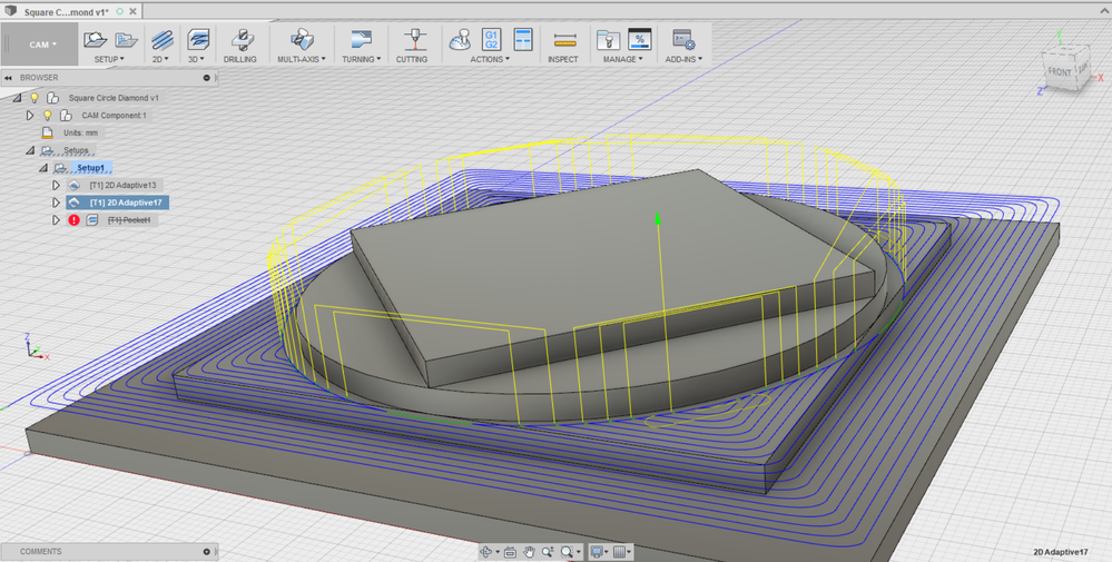

I would like to create a circular toolpath to mill out the cylinder area in the picture shown instead of coming up to the cylindrical profile at right angles. I would like the passes to be more like the "Circular" option under 2D toolpaths. I am very new to this, any help is appreciated! Thanks.

2D Pocket should get you fairly close to what you are looking for:
Attached file for you

Seth,
Thank you for your help! Much appreciated!
