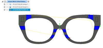

I can't select the parts in the red boxes (cf picture attached) while I'm setting a 3D parallel manufacture.
It is odd I can select the green parts just fine (the one in green in the picture) but for the other parts, it is choosing another path (it's the blod line in the picture)
I also put a side view attached for you to understand why I need parallel manufacture.
Do you have any clue why it is doing that ?
Thank you for your help,
Nolwenn

Thank you for your answer. Here it is !

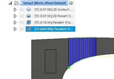

OK, if you are not able to access the "Blend" toolpath then here is a method of selecting the areas you want to machine, using a single "Parallel" toolpath will make all the selected areascut in the same direction, if you want the top two areas to cut in a different direction then you need to make a second "Parallel" toolpath 🙂
The Green rectangle in Simulation is your Stock material
Hope the above helps

Amazing ! It works perfectly fine, thank you very much.
