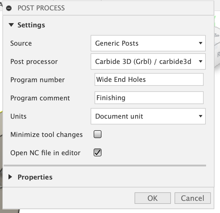

I think that was Michal's part, here's mine if that's useful. I've been able to repeat this issue on several models and none of them generate a valid to GRBL drilling operation.
Op 1 Spot Drill from the attachedopens with;
(Op 1 Spot Drill - 4mm Spot Drill)
(Finishing)
(T9994 D=4 CR=0 TAPER=90deg - ZMIN=0 - spot drill)
G90
G17
G21
(When using Fusion 360 for Personal Use, the feedrate of rapid moves is reduced to match the feedrate of cutting moves, which can increase machining time. Unrestricted rapid moves are available with a Fusion 360 Subscription.)
G28 G91 Z0
G90
(Spot Drill)
T9994 M6
S2500 M3
G54
G0 X26 Y26
Z20
G1 F0
G0 Z10
And that's from;
V 2.0.9.009
macOS 10.15.6
The model Simple Test Paths is in the Shapeoko project if it's easier for you to grab it from cloud storage.
I've also attached a screenshot of the post process dialog box to confirm the options there.
