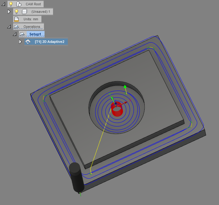

HughesTooling
Pocket is a bit misleading as you can use it to machine the outside of a boss as well, like this.
It will even machine the pocket and the outside in one op.
It sees the blue shaded area as material that need to be removed, clicking the red arrows changes the side to machine.
3d adaptive will give you more options, here 1 op does the facing and machines the outside and pocket!
File's attached so you can see how the ops are setup, to open in Fusion use New Design From File on the file menu.

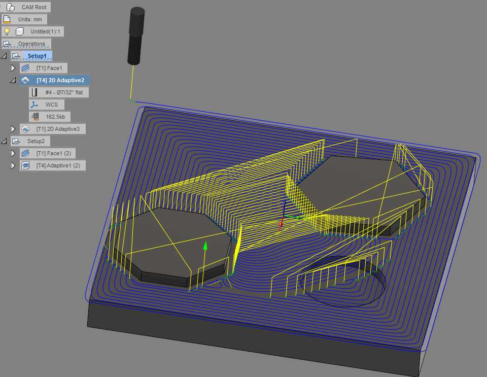

HughesTooling
bossmanu wrote:
if I have a panel with height 10 mm and my model has to be 10mm in height do not make facing .... while if it has to be high in the Setup I will have 8 Stock - Top Offset 10 (2mm will be removed) ?
ATTACH Facing test
You are correct you don't need a face operation if the material is the correct thickness to start with.
I took a look at your file and it's OK but don't be afraid of using the 3d Adaptive as in some circumstances it does a better job. In your file the top of the round pocket is left unmachined, that might be OK but if you want all of the level machined, 3d Adaptive does the whole level.
2d Adaptive
3d Adaptive.
I've attached the file with both versions. See setup2 for 3d.

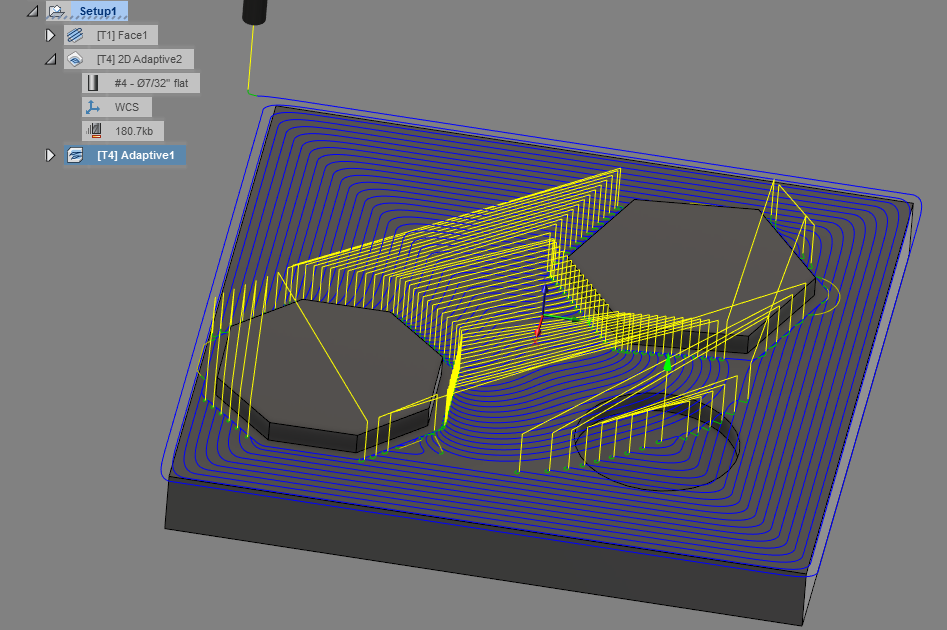

HughesTooling
I just took a look at how you setup the facing op and noticed you've activated Tool Orientation, you only need this if you have five axis. The orientation of the part is done in the setup so for 3 axis you should leave this unselected.
Also I just remembered how to use 2d Adaptive to machine a face with pockets, select the face under Geometry and activate Stock Contours.
Gives the same toolpath as 3d!
Mark.
