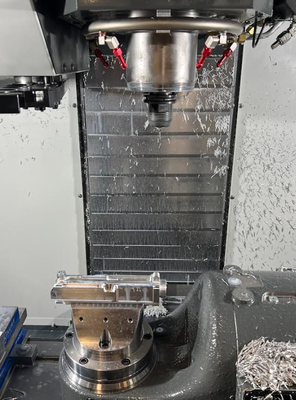

Hello world,
This is likely operator error. I will do my best to show what I have going on, but Can't share the actual files I am using. I can make a simplified version if someone needs a file .
Machine is a Haas VF-2SS with TRT160
Fusion WCS has TRT positioned at A-90 so I can probe a feature from previous operation.
Any post with a non setup WCS (tool orientation) then moves incorrectly by this -90 from the original WCS.
Picture of the WCS below as well as well as a tool path setup and how it actually orients in the machine.
WCS Setup
Tool set up
NC. snippet. A180 would be correct position
Actual positioning in machine

Based on your first image, I assume you are using the correct Machine Configuration and related post processor, right?
I know what that part is, so I understand that you may be unwilling to publicly share it. Would you be able to share it privately?
Email it to me: [email protected].
Please link to this thread and specify which toolpath is posting out like this.
Does this only happen when you have one toolpath selected for posting, or is this a toolpath in a whole collection of toolpaths?

Addressed via email. Basic explanation is to use Machine Configurations and the appropriate machine/post combination.
