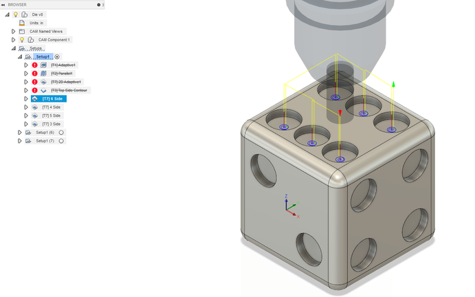

So Im trying to run a test piece on our Haas VF6 with a TR310 Trunnion.  My issue is when I post and run the program, my tool paths seems to be 180 deg out on the Z Axis.  Maybe my program is setup wrong, or something in my post file, Im not exactly sure.  Here is what I have so far:
SetupSetupTool Path for "6 Side"Tool Path for "6 Side"
So after I post and run the program on my machine.... My first 4 toolpaths work out perfect since they are only running 3 axis, but when I go to run the 5 axis portion here is what I end up getting as a result...

What am I missing here? Is it my post or is it my setup? I have DWO/TCPC on my Haas.  The post Im using is the current Haas NGC post.  Seems like no matter what I do, my tool path starts 180 deg off. Is my G254/255 in the wrong spot? If I turn on G234 I get an error in my machine. Hopefully everything I said makes sense. I have attached my .f3d file as well.

I think whats going on here is your a axis is actually incorrect. Either your machine was setup incorrectly or you actually need a-90. c0 which is the other possible rotary solution.
as far as the x and y axis they are relative to where the offset has moved to. The position stays the same but the z axis will "appear" to be wrong depending on what your looking for. Just trust the computer as 99.99 of the time it is correct.
tcpc is only active for simultaneous 5 axis movement and cannot be used in conjunction with dwo.
I edited a post for the ngc and you just have to activate a axis and c axis when you go to post process.
Also from my knowledge and experience  with the ngc control, there cannot be an active a axis offset on the desired work offset to achieve the proper calculation. A axis has to be 0. C axis can have any value.

Thanks a lot for the help Devonm.dupius! You are right, it was my machine setup in my post processor.  Your post worked, I just had to switch it around so that the A-90 would be a positive value for me so that the trunnion was facing me instead of away from me.
I still have one issue but I think it is with the DWO/TCPC instead but I need to run a few test samples to make sure.
