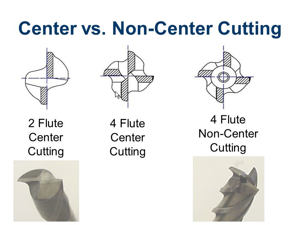

And one last note, not all endmills can plunge. In order for an endmill to be able to plunge, it has to be a center cutting endmill.
slide_6
If you try to plunge with a non center cutting endmill, you will crash your machine.
If you already knew all that, then no worries. But I thought it would better to be safe than sorry wit this and explain the proper terminology. Hopefully that doesn't come off as being rude, just don't wanna sound like a rookie machinist now, do ya? 😉
