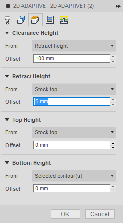

As far as calculating a safe location, inside your operations you should have something called a "retract height"
The retract height is where the tool will start and end the operation. So if you set that to be higher off your part, that should serve as a good safety. Then you could just retract in the Z direction.
In the end, the best method to fix it is the one that works for you. Just test first, making sure everyone moves as you expect and you should be good.
Let me know if you have any additional questions about it!

I've not been able to find with in the Fusion 360 GUI a settings called "retract height", where would I find this and how then would I reference it in the POST ?
It still seem to me that on the CTX410 that the G28 is behind the chuck so it will clash.
Mike
xander.luciano
In each operation.
ziLyLJX
You shouldn't have to change anything for that. You can change that value and simulate the toolpath and you'll see the clearance. Though that leaves it on you not to forget about changing that, so I would stick to the G53 implementation you did.
I think what you did is a the best option. I was just mentioning that as a way to give yourself some more clearance.
