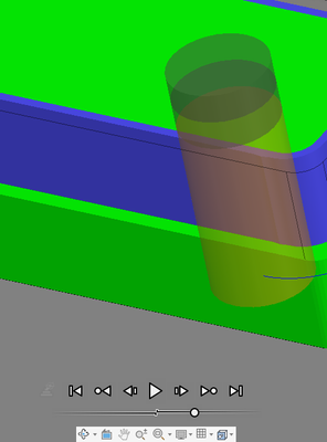

programming2C78B
Please confirm your slider looks like this (dot to the right)
I guarantee that you have it to the left, which plays it backwards.
Please click "Accept Solution" if what I wrote solved your issue!

Please take a look at the video; it shows the processing, but without the transparent outline like in your version. What is this transparent outline for, and is it possible to do without it?

Vadim...
if You take a look on my model in design mode, You will see two bodies. I gave opacity/transparent to stock body 50%.
If You take a look on setup, You will see that I used solid body for stock.
This is the reason why you can see transparent part in simulation.

Slider in simulation window MUST be on the right side, in Your simulation window is in the left side! Simulation go in the opposite direction.
