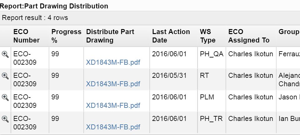

Hi Martin,
I initially, during development, thought about using the above mentioned method but we utilize reports heavily to see pending tasks.  When Engineering finishes their work, the result are part drawings and multiple records are then created for specific departments to monitor their progress.  In each new record, I write to a field all the hyperlinks for the attachments.
Each department point person can now view and have easy access to the drawings through a link in their report.  Here's a sample image.
