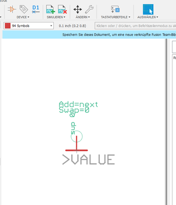

I have created a library and a custom symbol but it does not show up in the library - only components and packages are listed and thus I cannot add it to my schematic.
Assumingly a component, and/or footprint and package is needed. I dont get that idea, as not everybody is interested in PCB design. I want to create complex  cable harnesses instead. As I will need many custom symbols, I would need a simple workaround to just work with custom symbols in schematics. I have watched a lot of videos, but hey are all dealing with older versions (and "devices"); I am using the latest version.
thanks for any idea.

Any help is appreciated. I dont even manage to link my custom symbol to a new component. I can add footprint and 3D, but dont find a way to add my symbol. Thus I cannot connect any pinsbto pad. My version does also not have the add symbol icon from the autodesk help

that I had tried out already, but it had changed nothing. ( what about the entry  fields for "value", "variable", "attribute sets" ?) What would be th expected effect of that attribute ? Would the symbol then show up in the library ? Until now, its just the component with the footprint, no symbol.
As mentioned, when creating a component, I don't find a proper way to link the symbol to it.
There is just no button, function or other means related to the symbol. I cant see how to do that
connection. Adding a footprint, or package, 3D is no problem, just the symbol appears nowhere.
How do I include the symbol to the component. I saw a video where there was an "add symbol" icon - that I don´t have in the menu. In content manager, clicking on my component shows a menue with the footprint and the 3D plus buttons for "new", "connect", "prefix". The Grid where I would see my symbol is empty and I did not managed to like drag the symbol to that area. Clueless...

the process is clear, but still it does not work (for the newest Fusion). I cannot add the symbol to the component
like described, as I dont have that symbol.
I added symbols using another method though, so I can see them in the Content Manager view. But only there. I also pushed the component to the lib.io.
When I now want to put the symbol into my schematic, using the "place component" view, clicking on my component, reveals only 3 empty placeholders, were normally the symbols, footprints etc would be.
I also tried to add existing symbols to a component. the show up in Content Manager view, but not in place component view..
I dont understand this..

meanwhile, I did all from scratch, no error with linked library, but same result. no symbols visible/useable in component, so I cannot place them in schematics.
the whole symbol concept seems odd anyway - there is no mentioning of symbols in the library, only
footprints and 3D models. same with packaging.
what am I missing out here ?

Hello @j_dommasch ,
next try:
  • You have to change the "direction" of your pin in the symbol from "io" to "sup"
  • Save everything and it should work 🙂
    Here it does
