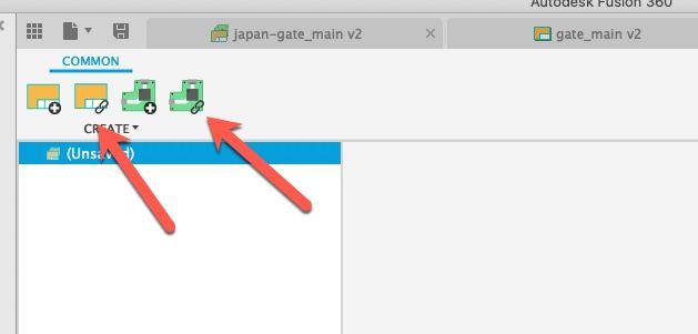

kschepens
I now get the message "board and schematics are not consistent". I don't understand why this is again.
But when I check them, they use the same device in the schematic and board. How do I fix this?

Ok, I'm just going to keep updating my adventures so that maybe other people will benefit.
So, for some reason the components that I replaced on the PCB document (or board) were not updated to the schematics so the schematics were using different packages from the old library. I personally think this is a bug in Fusion 360 (it should have updated the schematics, regardless of whether the Electronics design tab is loaded). Somehow the link between the board and schematic got lost.
Once this happened, it's a mess: new changes will not be synced between the 3D model and board and schematic. This needs to be fixed first. So I manually replaced each component with the one from the new library so that the schematic and board/PCB document match.
After that, the link between the schematics and PCB document (board) seemed to be fixed.
Next challenge: trying to fix the 3D model.
UPDATE: I removed the link between the board and 3D model (on the board choose Switch > Remove 3D PCB Link) and then re-added it (Switch > View 3D PCB with canvas). This solved the issue.
