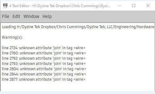

We are wondering if the added 'Join' attribute is corrupting the parsing of the .BRD file. If things are only pushed off by one field and we can edit the file, that would be OK. It has to be fixed in Eagle since the DB has to be written out from Eagle.

Removing the join="flat" referenced stopped Eagle from throwing up the dialog, but the wires still have rounded ends, which makes this unworkable.
This is one of the areas where Fusion has an edge over EAGLE. EAGLE only support flat trace ends on arc objects. In Fusion, traces can have either the default rounded end or the flat one.
