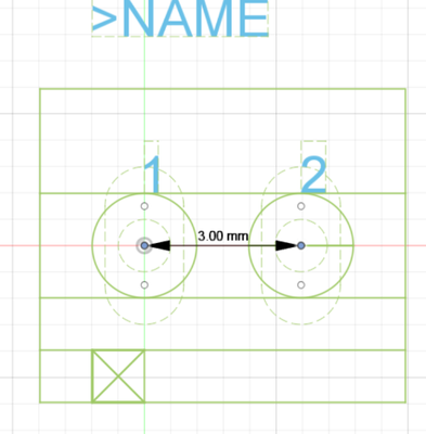

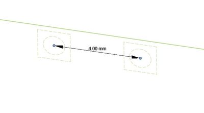

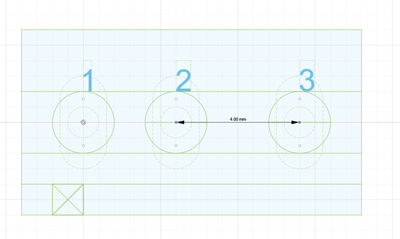

I've got a problem with creating a new 3d package. I have 3.81mm footprint (you can see by grid, but where is dimensions tool in the footprint editor??)
When I create new 3d model distance between pads is wrong
I am not able to correctly create 3d package, because positioning is not possible. What is more, when I create 3d model from another socket, 3 pins this time, I get this!

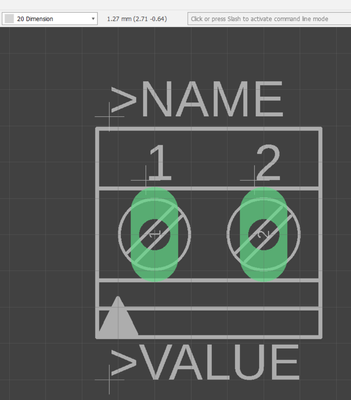

For the Dimension command, it is in the dropdown list of Draw Tab.
And you can also activate by Press 'D' in the keyboard.
And for the wrong size issue in 3d package, I have a try and I can see the correct result.

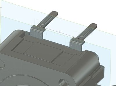

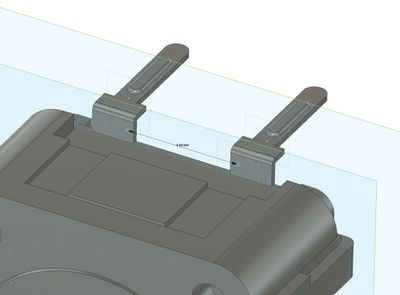

I'm facing the same problem.
I just created a new footprint with two pins 5.0 mm apart. I then right-clicked on the Footprint in the Content manager and selected "Create New 3D Model". The 3D opens showing where the pins should be located. When measuring the distance between the same to pins, it is shown as 4.0 mm.

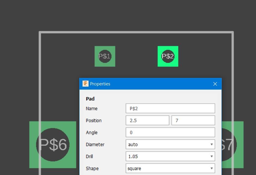

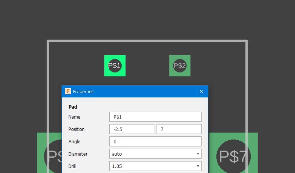

Please find the library attached.

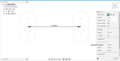

Before I exported it, I tried to verify the bug once more. This time, I noticed something different. After I clicked "Create new 3D model", and the 3D view opened, the dimensions were correct. Then, after I added my STEP file into the 3D model, a second layer of pads appeared, with incorrect dimensions. Please see the attached screenshots.

The issue you reported has been resolved with the latest Fusion update (2.0.11183+), if you open the inconsistent footprint and 3D package, syncing would proceed automatically. Save the file could resolve the inconsistent problem.
Would you please have a try?
