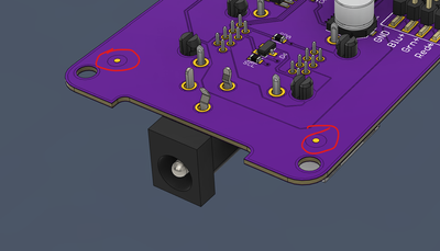

TrippyLighting
Something must have recently changed, because this worked. The Fiducial has a round SMD pad in the middle.
Surrounded by two circles with width, one on the tRestrict and one on the tStop layer:
On the board this results in the solder mask not being kept off the area in the tStop layer.
This worked previously until I changed a component in the library and updated the board design from that library.
This is also only a problem in the 3D model. The CAM preview shows this properly.

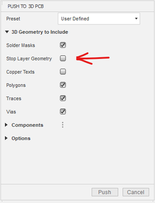

Message 8 of 8
TrippyLighting
Looks like I simply needed to enable "Stop Layer Geometry" when pushing to the 3D PCB:
