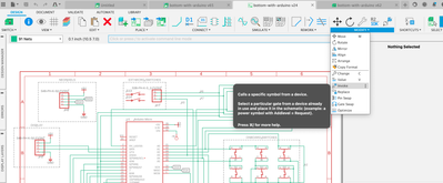

there are library components defined that consist of several symbols. These so-called gates can be placed individually (depending on the Addlevel set in the Component Editor) in the schematic. They can be distributed over several sheets.
So, please use the Place Component panel to add the first gate of a component. As long as you stay on the same schematic sheet you can add one gate after the other.
As soon as you go to another sheet in the schematic, you have to use the so-called INVOKE command which is accessible in the Design / Modify menu.
Activate the command and type the component's name in the command line (or click on one gate of the component in case there is already one placed).  A menu will show up now that allows to select non-used gates of the component.
I hope this helps.

This is working for sheet's but when I try to Invoke a component inside a Module it was not accessible

I hope you're doing well. You can't split components across modules, this is a limitation of the hierarchy implementation.

I couldn't get it to work. As far as I understand, I tried to do what you said, but it didn't work. I have placed 3 components of a 4 component part on one sheet, and then I run the invoke command on another sheet, but it does not see the part on sheet 1. I think I am doing something wrong.

You have to run invoke on the same sheet where you have the 3 components. Click one of the components a small dialog will pop up allowing you to select the missing component and bring it into the current sheet. Once it's in the current sheet you can move it to whatever sheet you want.

Thanks for the help. I have one question left. "Once it's in the current sheet, you can move it to whatever sheet you want." Do I need to cut and paste the part for moving to another sheet?

I hope you're doing well. No, don't do cut and paste. You do a group Move, you are moving from one sheet to the another. If you do a cut and paste you'll be deleting an instance and then inserting a new one which is not what you want to do.
