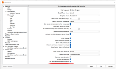

Could you please uncheck the checkbox about "Use gesture-based view navigation" from Preferences dialog > Apply changes > Restart Fusion to have a try with Mac trackpad again? Suppose it should work then.
Looking forward to your feedback. Thank you!

Turning off gesture-based view navigation does seem to prevent the canvas scrolling problems in the PCB side, but doing so makes the rest of Fusion unusable.
I appreciate the effort to look for a workaround, but event plumbing in the PCB side needs straightening out. Hopefully somebody is tasked with that.

Kindly reminding that now with the fix in the latest Fusion version 2.0.17954, you could check the option about "Use gesture-based view navigation" in preferences dialog again.
Hope it helps.
