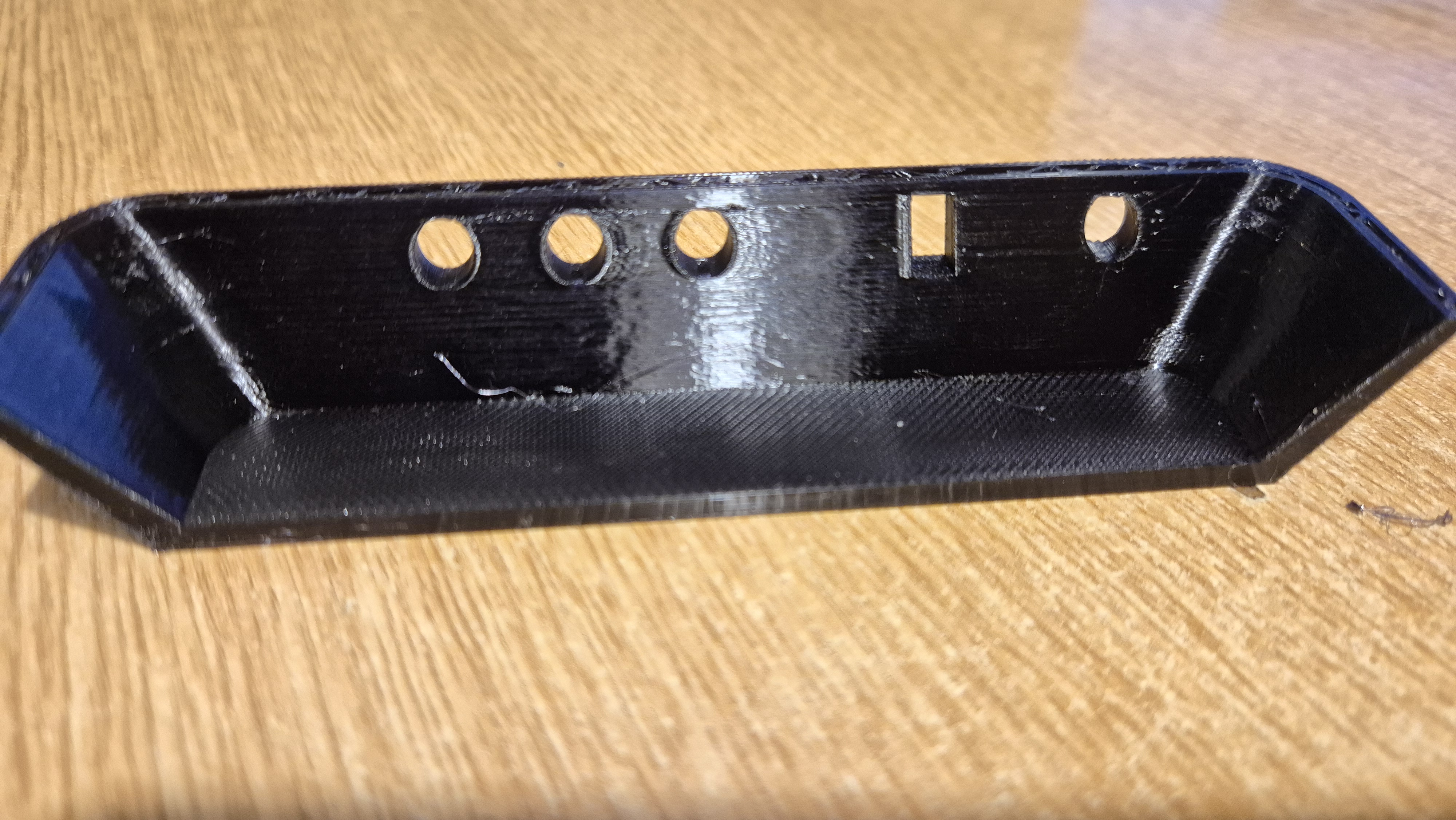

Using the loft tool I created a box with a smooth transition between its' sloping sides and the base
but
when printed the surface finish on two sides is awful, the other sides are perfect
In the example shown the surface with the LED's is poor, the one with the USB socket is good
I did not use any supports as the angles arent that steep and am printing in PETG @ 0.12mm layers on a new Bambu A1, the "good" sides are super smooth and very even
Other projects are super smooth all round
Any ideas please

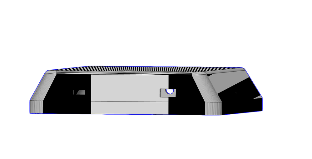

I don't think that this is a Fusion modeling problem.  The geometry here looks fine on both sides.  I show Gaussian Curvature and Zebra Stripe analysis:
Screenshot 2025-01-01 at 6.50.07 PM.pngScreenshot 2025-01-01 at 6.49.57 PM.pngScreenshot 2025-01-01 at 6.49.23 PM.pngScreenshot 2025-01-01 at 6.49.14 PM.png
So, I suspect that the problem is with your printer, or the slicer, or the software driving the printer, but I think the model is fine.

It is strange that the other sides and also the vertical part above the slope all printed perfectly.....

I tried printing it with and without supports but the result was exactly the same
The INSIDE printed perfectly smoothly, the outside was very rough and poor
It APPEARS to be the result of the “loft” function which created the sloping sides but we cannot see why
Have attached the test piece for other suggestions
Thank you

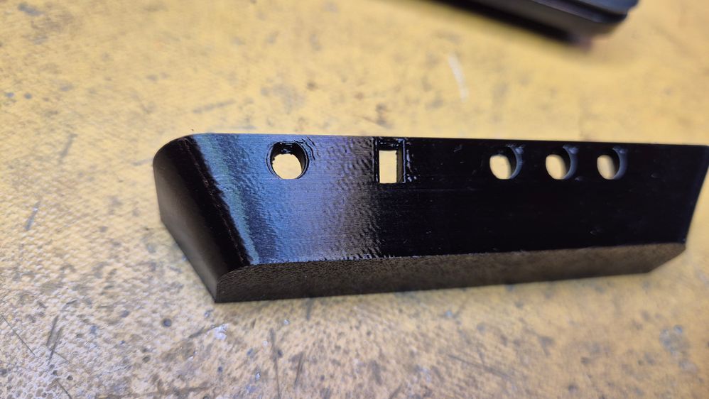

Hazah.... we (my son is the brains 😁) applied the create mesh as you suggested and the result is superb and fully acceptable
thank you
attached examples printed @ 0.12
