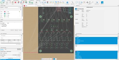

I've posted about this a while back, but didn't get a response that helped to resolve. The right side data panes always start with the width being about 1/3 of the full screen. The left side always starts at what I would call the "correct" size. Every time I start Fusion Electronics, I have to resize the right side panes in both the schematic, and 2D PCB windows. Picking the edge of the window to resize it is also challenging since the cursor wants to jump away from the edge.
Is there a way to get Fusion Electronics to "remember" the pane sizes?
This issue is present on all three computers that I use Fusion 360 on. I have to believe that this issue is somehow limited to my install since if this was happening for everyone, it would have been fixed by now.
Suggestions are appreciated.
