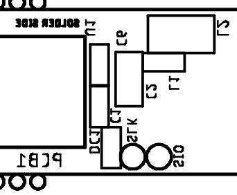

I am making pcb file in fusion , when my design was finalized, I  re arranged all idents of components neatly
now for preparing pcb panel, I need to rotate all pcb design in specific angle for adjusting proper panel size
While doing so all the idents of components are also getting  rotated,
as per my understanding this will not tobe happened, idents are kept as it is
also share image for  better understanding
this is individual pcb
this is pcb while rotating by angle 90 degree for panel purpose
Please if you can do, keep ident as it is after rotation of pcb layout

Hello @anuradha.bodke ,
I hope you're doing well. This is where you would use the spin flag on the text. By default the text always auto rotates to be "easily" readable. If you go into the properties you can check the spin flag for the text which will make sure it doesn't auto rotate.
Let me know if you continue to run into problems.

That means if I don't want to rotate idents of components even though all pcb layout rotate. for so
I have to on spin command in property bar of all components
is it correct, because I don't want to change idents of components as I already arranged them

Hello @anuradha.bodke,
I hope you're doing well. Technically, you only have to set it on the texts that are rotated the wrong way but easiest to just set it for all of them.
