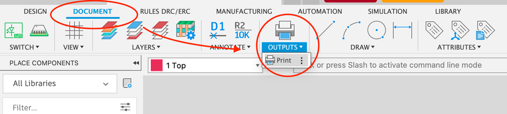

I would like to know how can I print my footprints to A4 size paper so I can check if the components fit?  (as in the picture below, which I saw from another forum)
I am in the 2D PCB view but I don't see an option to print. Please guide

Hi @mohamed.ali2EVMWW ,
If you are on Windows the printer functionality still works fully. Go to your 2D PCB, Document menu, you'll see a printer near the middle of the bar.

mohamed.ali2EVMWW
I don't see the print button but I was able to bring the print dialogue by entering the "print" command.
Here is my print result and the footprint seems ok.
Thank you very much for asking.
Glad to see you run the print command already.
Want to share with you that you could access the print tool via Document tab > Output > Print. Hope it helps a little.
