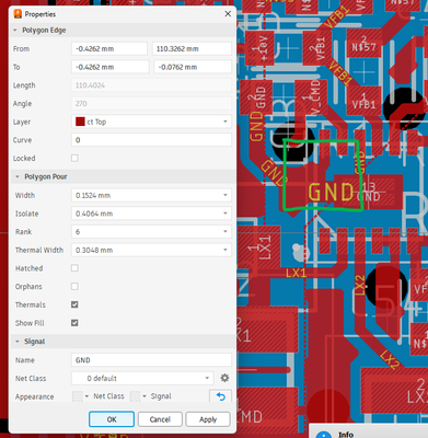

I saved a new copy of my design and made some changes.  However, some polygons have changed in an area of the board I haven't touched.  I made no changes to any polygon properties.
see pic areas highlighted in blue
ORIGINAL POLYGONS in previous design
NEW POLYGONS in updated design
Why are the polygons no longer connecting?  Their properties are identical in previous and new versions.

The properties of the 2, top copper polygons (GND & V_CMD) are unchanged.  No design rules changes were made.
Properties of previous, OK polygons
Properties of new, NOT OK polygons
As you can see above, the polygon properties are the same for respective polygons in previous and new copy of design.
Design Rules
OK Polygons, previous design
 NOT OK Polygons, new copy of design
The design rules are identical.  There are no custom rules.
Just to reiterate, I saved a copy of an existing design and changed components in a different area of the board.  I made no changes to Design Rules or the properties of these 2 polygons (V_CMD, GND [both top copper polys]).  I only became aware of an issue when I checked design rules.
The only polygon I changed was a GND poly on the bottom layer.  I reduced the isolation property to ensure the ground pins of an IC connected to the poly (I posted about that here, https://forums.autodesk.com/t5/fusion-electronics-forum/only-some-gnd-pins-connect-to-gnd-polygon/td...
I'm missing something, probably obvious!

Your image shows the issue 3 board.  The problem appears on the issue 4 board.
On the issue 4 board there are 2 polygons (GND & V_CMD) which no longer make contact with 2 pins (as shown in earlier images).  For the issue 4 board I instead have routed 2 wires to make the connections.

I hope you're doing well. So if you unfill and refill 3, you'll see that the polygon recalculates to not have the thermals. I know for this release we had to fix a major thermal bug and this seems to have the unintented consequence you are seeing on these boards. I'll create a ticket for this and share it with the developers.

Ok thank you.  Yes when I hide then show polygons in Iss 3, the thermals disappear and do not return, as you say.
