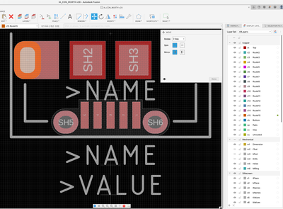

For example, a fairly complex footprint for a Wurth USB Micro-AB receptacle:
As a workaround to support both 16- and 64-layer stacks given that don't envisage using more than 16 layers, I would want to copy layers 9-15 to 57-63 so that both exist within the same footprint.

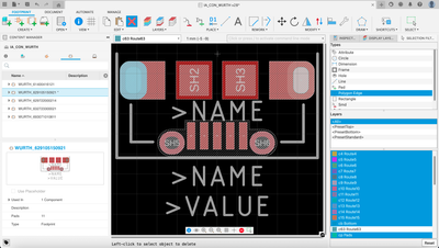

I confirm that with the latest release I am not presented with all 64 routing layers, only the 16 routing layers that were the maximum when the library was created.
Using the command LAYER c63 Route63, I am able to create a routing layer such that I can copy a polygon shape from another layer, but I note the following:
  • Layer c63 appears out of sequence - it is after layer cb Bottom
  • When I select All Layers in the Selection Filter, layer c63 is not selected
When I create a new 4-layer PCB, the layer c63 polygon shapes and pads are correctly displayed.
In this case, the Selection Filter shows:
  • Layer c63 appears in sequence
  • When I select All Layers in the Selection Filter, layer c63 is selected
So I think the expanded layer implementation in Electronics Projects is ok, but perhaps some work needs to be done in Electronics Libraries.
