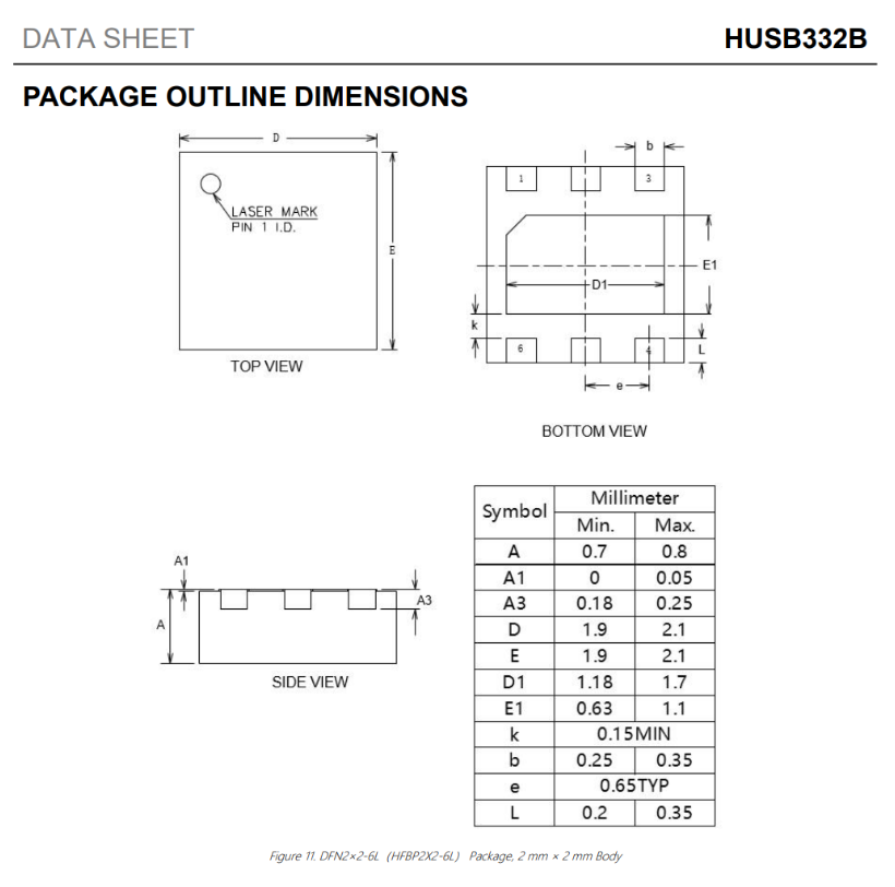

When creating a SON (DFN2x2-6L) package using the parameters L = 0.3mm and b = 0.3mm, the generated 3D model renders incorrectly (as shown in the attached images).
Currently, the only workaround is setting the b parameter to a slightly smaller value to get it to generate properly; using b = 0.29mm or smaller works as a temporary fix.
Please review the SON Generator logic for this package type to resolve this geometry conflict.

If you use different L and b parameters, it generates the 3D package using the larger volume (the max values) and it usually works. However, in this specific example, when L = b, the current SON generator may fail. So, setting aside this specific datasheet, please fix the issue when L = b = 0.3 mm, which is a perfectly valid possibility in any datasheet (a perfect square SON or QFN pad).

I'm sorry, Jorge, but I'll have to disagree here. I have literally hundreds of 3D packages in my libraries that use identical min-max values. That isn't the problem.
The issue only occurs with L = b = min = max = 0.3mm in the SON package generator, which is why I reported it as a bug. The 3D representation of the pads below the package ends up in a round shape, while the exterior pad edge is flat, and that internal pad radius edge calculation has a bug when the pad length is equal to the pad width, that is, when the SON package pad is perfectly square. The QFN package generator probably has the exact same issue, but I haven't tried it yet.

I get your point that L should generally be larger than b, but in reality, I already gave you a counterexample with the HUSB332B package. L can be 0.2 mm while b_min is 0.25 mm, so b can definitely be larger than L. This means the SON pad could be perfectly square, or even wider than it is long. The SON (and QFN) package generator in Fusion 360 should support b >= L, and having min equal to max in any field shouldn't cause an issue; it should generate the 3D package correctly in all of these cases.

Here is another example of a package where L has a min=max=0.4 mm, with no tolerance range.
This proves that min and max can perfectly be defined as equal values for any parameter of the package.
