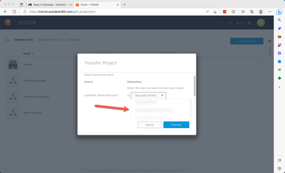

Hi @truher I think there is a better way.
Switch to the team/single user storage that you want to move the data from. Make sure that user is a member of the Team you want to transfer the data to. In the data panel, open the project and then click the globe with the eye on it (open on the web)
That will then take you to an online view of your data in a web browser. When you get to that screen, click the home icon to see a list of all your projects.
You will then see a list of all the projects for that team or single user storage. Hover your mouse over the project you want to move and place your cursor all the way to the right of the row of the project. When you do, you will see a dropdown where you can choose to transfer the project to a different Team
In the next screen, you can transfer the project to any Team you are a member of, providing you are the owner of the project. (Team names blurred out as they are customer Teams I am a member of)
Once you choose Proceed that project will then be moved to the Team you chose. You can switch to that Team and access the project you just transferred.
Does that seem like it would work better for you? Let me know if you have any questions.

did you try this method using the "folder" project type?  for the view i see, for the "folder" project type there is no "transfer" item in that dropdown list, as i indicated with the words "there's no transfer' button" in my post.
