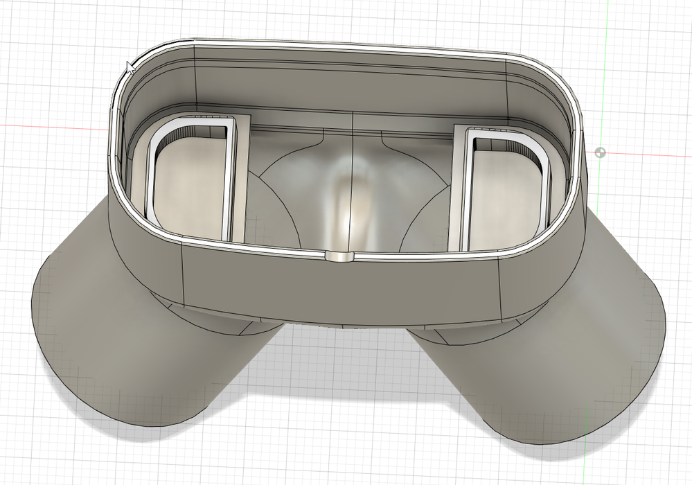

I am totally new to Fusion 360 and trying to reconstruct a design, that I need for our hospital as personal protective equipment.
At our Intensive Care Unit, we need better protection at high risk procedures like in-/extubation, tracheotomy, etc. Despite the shortcoming of FFP3-masks, we decided to use the Subea 500 Snorkelmask from Decathlon as described in various documents and website all around the world for a better protection. An adapter with two 25mm ISO-connectors made from Filip Kober (https://grabcad.com/home/inbox/7650461) fits onto the Version 1 mask, which is outdated and not manufactured anymore. The version 2 mask (see above https://www.decathlon.de/p/schnorchelmaske-easybreath-500-oyster/_/R-p-148873?mc=8491266&c=BLAU_T%C3... ) lacks a special adapter with these two hose connectors. Filip provided for this newer model only an adapter with one connector as shown in the attached files.
I tried to construct such an adapter in Fusion 360, but due to my lack of knowledge, I wasted instead more than 30 hours in internet recherche, tutorials and trial and error without any luck.
I tried to contact Filip, to develop a version we are in demand or to send me the original CAD files. But due to the hurry of the situation, I decided to ask here for a solution too. And for me and my learning curve in CAD it would be better to understand, how to do it myself, instead of just printing given designs 🙂
My trials and errors so far below:
  1. approach: Import the STL files into Fusion, cutting out the needed part of the version 1, cutting out the part adapter part of version 2 and try to merge them after and before converting them into BREP-> fail due to lack of knowledge after hours of reading tutorials and the like
  2. approach: Using the STL file of the adapter part of version 2 as a template with Splines to get the correct shape. Then trying to extrude/sweep/and other stuff to get a workpiece like in the attachments. -> fail again
  3. and some other attempts I superimpose the cloak of silence. 😉
So, I hope the community can teach me, how to do it properly.

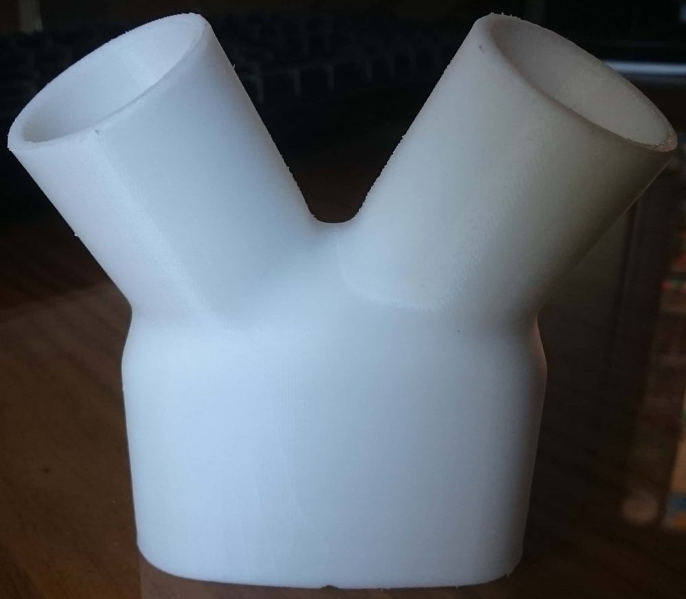

This morning my printer spilled this out:
AdapterSubea500.jpgAdapterSubea5003.jpgAdapterSubea5002.jpgAdapterSubea500HME.jpgAdapterSubea500HME-Venturi.jpg

The adapter itself is leakproof, but, while the adapter and the venturi nozzle is FDM printed, it is very necessary to sand and smooth the surfaces of the connectors to ensure a tight and leakage free fit. It turned out, that making the connectors slightly tapered off to a point, the fit is much better. To this effect, I redesigned the ISO connector of one venturi nozzle and got a much tighter fit!
In one of my pictures I added a venturi nozzle on top of one filter. During my tests with the mask, it turned out, that the longer one wears the mask, the more sweating appears (who thought about that! 😧 ). So we tested, how we can improve comfort: After stacking this venturi nozzle onto one filter, applying an O2-/Airflow of approximately 10-15 l/min, we got a nice and soothing air flow, prevent sweating and cools down inside the mask. For working at patients, the attached O2-hose can be lengthened as needed to provide a comfortable range.
Meanwhile, I redesign (yes, my skills in Fusion360 improved greatly since my first impact in this forum! 😁) and print some different configurations of a venturi nozzle to optimize manufacturing process, i.e. optimizing FDM-printing to reduce print time and needed support structures as well as optimizing the air flow, because, whilst my printer isn't really bad at printing accuracy-wise, the original designs of the venturi nozzles with tough specifications regarding their dimensions, may not comply with the accuracy of my printer. Now, after printing a bunch of different samples, I'm going to test them in my clinic with our medical technician.
Hopefully, I get my new version 2 mask (Subea 500) soon, to test the fit of the adapter and get this design ready. (Hopefully it IS already ready 😀)

After extensive printing and testing, I come to this solution, which turned out best:
You just have to be cautious in forest...
Message 33 of 40

I was able to reproduce your building steps of the adapter. So , it was possible to modify the ISO connector to an inner diameter of 22,2 mm without problems, which turned out best to fit the filters and an outer diameter of 25,7 mm to reduce wall thickness and therefore print time. Wall thicknes of about 1,75 mm is far enough for a strong workpiece. My former trials of modifying were successful, albeit the approach was aweful. With a beginning understanding of the surface related approach, it is much more elegant! I learned a lot about using Fusion360 while researching your work step by step.
This moment, my printer is working the test sample and when its finished and satifies my need and requirement I would go and release it to the public. Maybe in Filip Kober's repository at grabcad.com.
Despite that, I am working on the design with the "plug shaped" pieces inside of the adapter. These thingies, which you ask, if they are necessary. Maybe they play a role in blocking CO2-revertive-respiration (dunno, if this word is correct...). So, it could be, that with them in place, less CO2 is back breathed due to reduced trapped volume.
But first, I have to manage the redesign of the adapter and do extensive tests after that. I think, it would be possible to cut and paste and do a few tweaks here and there to include these "plugs" into your adapter design. (Hopefully 😁) In a test session, I was able to draw such a design, but with my crude technique. Now I change to the surface modelling for more elegance...
Meanwhile, the present design works!
Many, many thanks for your effort and kind and fast help, Peter!

I modified your original design in two following ways:
1.)  I enlarged the connector holes up to 22,2 mm to better fit the filter connectors.
2.) as a second version, I added the plugs, I mentioned earlier. A drawback is, it has to printed with supports.
After some testing with the professional equipment of out medical technician, it turned out, that CO2-rebreathing is less with these plugs compared to the version without them measured on top of the filters. Which leads to the assumption, that the dead space inside the mask is reduced due to not (entire) filling the side pipes inside the mask, which are originally designed to lead exhaled air through the snorkel. While breathing under normal air pressure conditions, aka outside of water, without these plugs this exhaled air is rebreathed during inspiration, which leads to slightly raised CO2-intake.
I tried to maximize the middle hole for maximum air flow during inspiration.
In my opinion, these two solutions (the original Y-Piece with 22,2 mm connectors and the one with the additonal plugs) are now ready for publishing.
Nevertheless, my design pathway is far from elegant, but it lead to an acceptable result. Due to my lack of knowledge, I had some problems with the construction history. I had to shut it off for some reason.
If you don'nt mind, I would send these two designs to Filip for integration into his repository, if he wants to do so. But due to my messy pathway (and due to my lack of knowledge, I would like to ask, if you want to look over it, before publishing.
When we only publish the STL-files, its no problem with my construction path, because, it is not published in it. But when we decide to include the Fusion CAD-files too, I have to reconstruct it in a better way.
Please reply your opinion about it.
I'll send the files per p.m.
