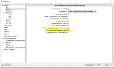

The "preferences->General->Design->Auto hide sketch on feature creation" option is automatically hide sketch whenever a feature is created from it. It is tick on default.
Can you please check the option at your end? It might be untick for you, please verify and comment if any.

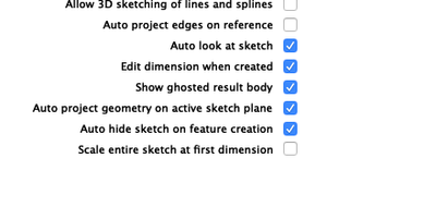

Thank you Sir! I had to ask google to find the preferences, but finally what I found wast that it was already checked.
