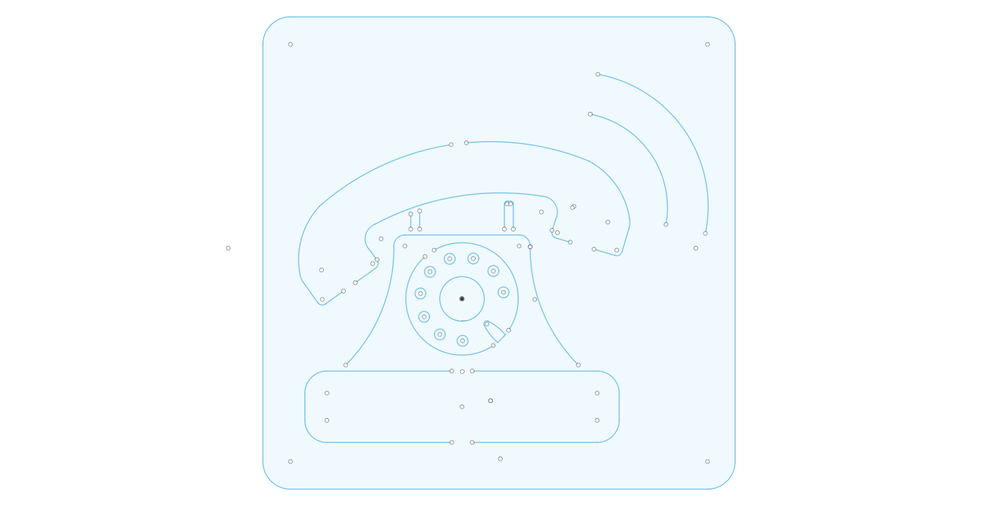

I am making some sheet metal coasters with an SVG file using a plasma cutting table.
I imported an SVG from Illustrator. I modified some lines. Now the lines that I modified won't show as black for cutting. The holes show up, which I did not modify. Screen Shot 2021-09-18 at 7.39.49 AM.png

You should be able to use that exactly the way it is.
Bring your sketch geometry into the manufacturer workspace. Make sure your sketch is not hidden.
When you bring up your 2D profile menu you should be able to select your geometry there there is some nuance to selecting all the individual little lines that make up one line so it cuts as one line.
If you posted your file I can walk you through the steps.

Is this similar of how it turns out in F360 for you?

With no constants, no measurements , no extrude you should be able to generate tool paths like I did here with only sketch geometry.
Split into 3 operations.
it is 4 x4 inch but I did not define any dimensions in the sketch. did enter a z height in manufacture set up.
Maybe there is something off with your SVG . post it and lets find out.
