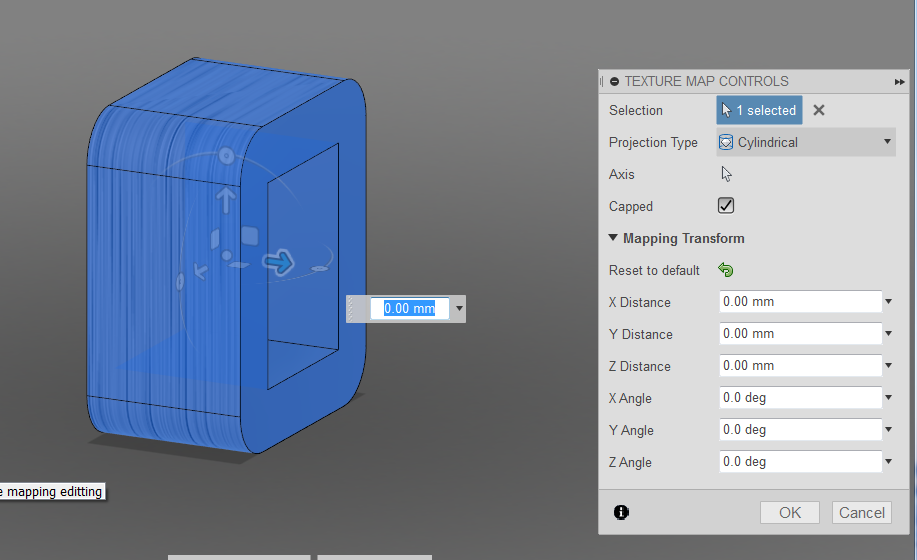

I'm looking to show a coil of copper wire wound around a rectangular form with radiused corners. So far I just have the outline I want the winding to look like (except the radius is too big). the real coil would be several hundred turns with stacked layers of wire, but I'd be ok with just the outside layer looking like the coil. Any ideas?

Oh, I forgot one critical detail:  You have to set the "Texture Map Controls" for the body to "Cylindrical" in order to get the brushed pattern to line up on the face:

Hi-
Thanks for the help. I think I did what you suggested, but I get a funny seam right on top. I tried applying another appearance, then the new one, but no luck. I also tried starting over but on a different surface, but the seam always came back in the same place. Any ideas on how to fix this?

jeff_strater
good observation, @Anonymous.  I did not notice that seam at first, but it does exist on my model as well:
I don't know whether you can fix this, to be honest.  Any time you have a texture like this, there has to be a seam, but I'm not sure why it doesn't occur on an edge, where it will be less apparent.  I will try to find out.
If you really want to try to model the wires, we can look at that.  I think if you don't really try to model the coil, there are ways that you could do that that won't be quite as expensive.
Jeff

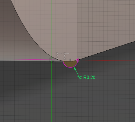

followup:  I tried actually modeling the wires.  Not as a coil, but as an array of bodies that were all the same.   I started with creating a sketch on the edge of the main body, and drew a semi-circle:

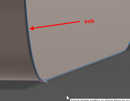

Then I used Sweep and picked the edge of the coil body as the path.  I chose "New Body", so I could keep the geometry separate:

But, the bottom line is:  This is pretty slow, and affects model size and performance.  I put my "wires" into a different component so that I could turn them off.  But still, compute performance is affected by this method, so use it with caution
