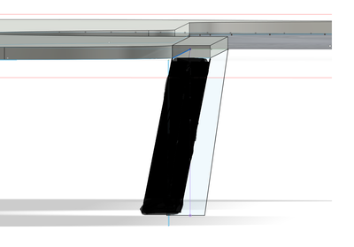

I'm extremely new to Fusion 360 and am struggling here. I'm trying to create a face cover for a handheld device, when the cover wraps around the sides of the screen. To do this I set up a sketch to represent the side wall and attempted to use a sweep to "extrude" the side of my face. However the sweep will not work and I can't figure out how to fix it. My goal is to set this edge up on the side, set a similar one up on the front, and then connect the two via revolve or loft.
Here's an image and I've also attached my model.

The error message tells you where the problem is, there is a sharp corner. It will probably be the point where the
curve meets the straight edge. Simply put a Tangent constraint on the line and curve and it should work.

Thank you for your input. I am going to walk through those tutorials. That being said, just for the sake of closure I did want to follow up here. First, here is an example of what I'm trying to achieve:
I would like this outer section to extrude downward at an inward angle. I created the "front" sketch to be the path on which this would extrude.
Per another comment in this thread I replaced my splines with arcs, and per your comment I added a tangent constraint between the straight line on which I'm attempting to sweet and the bottom curve. However it still did not work, it gave the same error. If I'm just in over my head here I can give up; I understand I need to do the tutorials and I intend on doing them before completing this project (I'm sure I'll start from scratch after doing so). But in the interest of learning I'm still curious conceptually why this doesn't work.

TrippyLighting
1. Ideally, the sweep path is captured in a sketch that includes the sweep path only.
2. The sweep profile should be perpendicular to the sweep path.
Neither is the case in the design you attached.

Maybe (probably) I misunderstand the full concept of a sweep path, but the sketch that contains the path I'm trying to reference only contains that:
The light blue area is the only thing within the "Front" sketch, which I have configured to be displayed in the screenshot above. I did some tutorials on the sweep function and this was my understanding...you'd create a sketch to define the path, then reference that path.
On #2 when I first started trying to figure out how to "extrude at an angle" I found multiple posts where sweeps were recommended for it, so I didn't think they were restricted to being strictly 90 degrees, which is what I imagine you mean when you say perpendicular.

It is unclear to me what you are trying to do, but try turning off Chain Select when selecting the Sweep Path.
Message 9 of 11
gregorylance
I'm trying to extrude that outer rectangle downward and inward at an angle. Unselecting the chain selection option seems to have worked for me. Thank you.
