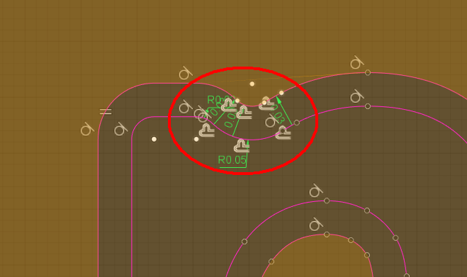

As the screencast shows, I can move the S but not the N.  Can't figure out why...  Trying to adjust the spacing between letters.  It doesn't generate an error and appears to do something but I am not sure what.

I can't see anything obvious from the screencast that would prevent the "n" from being moved.  It should be fine.  Can you post/share the design so we can take a look at it?

Yes, I can reproduce this behavior, and I will log the bug.
The problem seems to be that there are three offsets on the "n".  This is somehow interfering with the move, probably some solver issue.  The "s" does not have these constraints:
if I delete these constraints, the geometry moves OK, so if you are looking for a workaround, remove those constraints.

I did not add the constraints.  They were automatically added.  It may be because I did the offsets in segments in that area rather than as the whole loop.  Think I did the outer first and then offset for the inner.
The selecting of all the segments of the loop to delete is tedious as you did and are no doubt aware.  There is a suggestion to add ability to select the whole loop which would be a welcome addition to the functionality.

I notice that when the offset constraint is deleted a concentric constrain symbol appears.  Is it normal that the concentric symbol appears next to the center point?  (Rather than as a different center point symbol)
Message 11 of 11
jeff_strater
Yeah, it's normal.  The idea is that if you remove the offset constraint, Fusion attempts to try to preserve the association to some degree.  So, for lines, you will get a parallel constraint between the original and the offset, and for arcs, you'll get a concentric between the two.  Whether this is a good idea or not is debatable, I guess.  But, yes, it's intentional.
