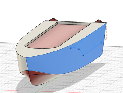

Fusion360 recognizes this plane as a faces as when I select it , it says 1 face at the bottom right corner. However when I'm embossing and such, I cant seem to use this plane as like the face select. Any reasons?

The Emboss command does not presently support compound angle faces.  This is why it will not select it.

You did not say but I am assuming you want to add material to the hull.  You can used Extrude and then Split Body to accomplish this.  Model is attached.
