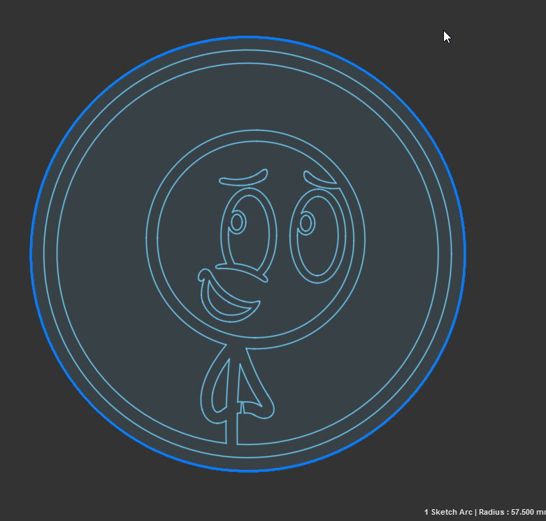

So I am creating a file in Adobe Illustrator an saving as a DXF and importing into Fusion 360. I have been troubleshooting this process for a while now and I am running into some more small issues, wondering if anyone knows how to "fix" this.
After importing the .DXF file from Adobe Illustrator, the circles in my sketch are imported as "control point splines". I believe Fusion is doing this because it doesn't "know" that the circles are circles and just reads them as lines. In fact every single line in my sketch is a control point spline.
This is not really a big deal but it becomes tricky when I try to measure parts of the sketch, like the diameter and radius of the circles. But since Fusion is reading them as control point splines, it only gives me the length of the line and not the diameter/radius.

Here is the DXF file. I didn't "fix" the problem, but I found a work-around. The design consists of 3 rings which make up the body of a coin/token. On each side of the coin I have a simple design that I extrude into the coin, almost like and engraving.
What I did was I just made sure I had the measurements of the circles from the Illustrator sketch, imported the DXF into Fusion, and re-drew the 3 circles in Fusion instead of using the ones from the DXF. It worked, but I feel like it could be a simpler process haha.

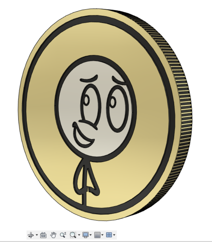

traditional.builds
This is the result of the coin after mirroring the extrude operation and adding a circular pattern on the edge of the coin to give it groves a real coin might have.

Message 6 of 13
TheCADWhisperer
Do not trim these in Illustrator.
Retain them as full circles.
They can then easily be trimmed in Fusion (actually, not even necessary to trim).
If you trim them they become splines.

@traditional.builds  I answered in your new post about the gap that's not actually a gap but a bad spline.
About the circle problem, if I open your file in Rhino you can see the circles are splines so again Fusion is reading the information in the DXF correctly, illustrator is just not exporting circles when it could. Don't know if there's a setting in illustrator for this.

Message 12 of 13
HughesTooling
I was looking at the DXF in the new thread. You are correct, the file in this thread does have circles and it imports into fusion as circles as well. Sorry for the confusion.
As @TheCADWhisperer states, the trimmed circles are splines though in Fusion and Rhino, so looks like illustrator has a problem with trimmed circles?
