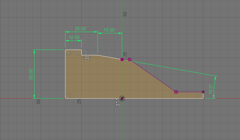

Note Sure what you mean by 'Soaking Mould', if it like an injection mould you have Combine on the modify menu that you can use to subtracted one part from another, but I think there's a better way for something like this.
First I'd draw the funnel as a revolve.

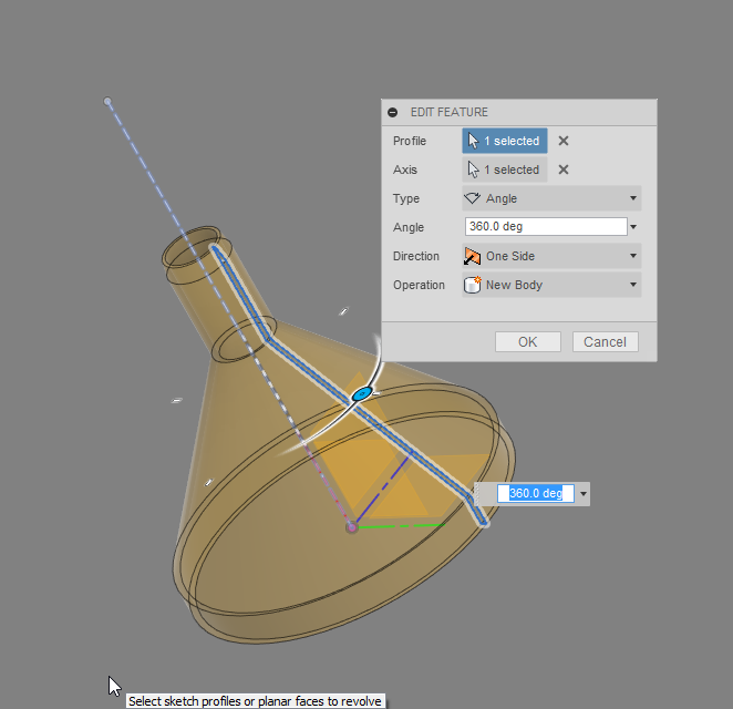

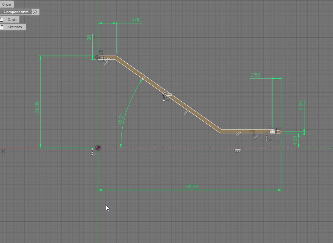

Make a component called Funnel then draw a cross section something like this.
Then revolve the sketch to make the funnel.
I'll put info on the mould in the next post just to make it easier for me to layout and edit.

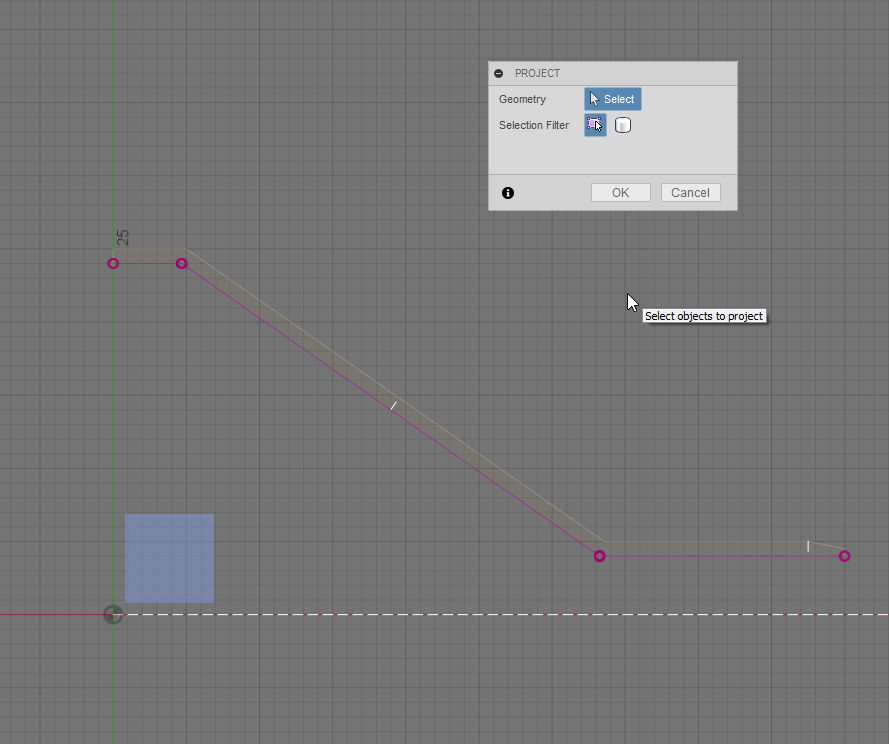

To model the core, make a new component and call it Core. Turn on the sketch for the funnel and project the inner profile into a sketch in the Core component.
Then construct the rest of the core and dimension and constrain.
Turn off the first component with the Funnel and revolve the core. After the revolve turn the Funnel back on and you should have this.

Making the Cavity is similar to the core, make a new component and name it Cavity.
With the Cavity component active start a sketch and project to outer profile and make closed by adding the white lines
Make another sketch for the mould plate and extrude, then use revolve cut to make the cavity.
Now if you make all the parts visible and make a section analysis you should have this.
Files attache, I'll leave the other plates for you to make.
