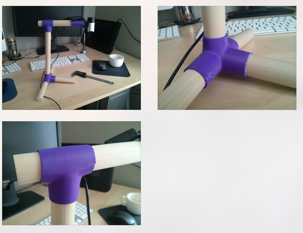

But that is ok - the data can easily be transfered. Recently for school I did a web cam arm fixture in Fusion brought it to Blender created
more organic joints, brought everything back into Fusion - my parts all were correctly positioned and dang used the timeline to create the
data for the Makerbot.
I researched this process quite well. Blender/Modo offer tools Fusion can never have and Fusion as much Blender Modo will never be able to have.
And while all in one application would be fantastic this process because data can be send two ways (missing part is OBJ export from Fusion TS) works spot on.
I never had any scale or position issue.
