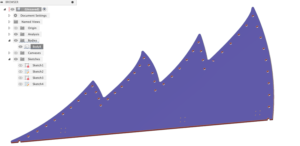

I have been dealing with this issue on this particular model. After extruding holes, a weird surface becomes noticeable.
It even appears when I export as STL
Any suggestions?

jeff_strater
This seems like a faceting issue.  Try changing the display detail control on that body:
Choose "fixed", and try changing to one of the choices (low, med, high).  Sometimes that can have an effect.

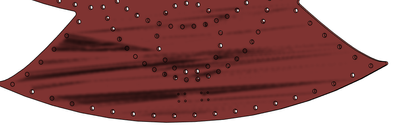

Also, this does indeed change the result of the exported STL. Here is an example of the original model, versus a early version that does not have as many features. In these pictures, I imported the STLs into VCarve, to be manufactured on a CNC.

jeff_strater
I don't think this is the sketch (other than there are lots of holes defined in the sketch...).  This looks to me like a classic faceting problem.  It shows up in a mesh export (STL) because conversion to mesh uses the same faceter as is used for the graphics generation.  Changing the display detail does help (on the sample here).  If I set it to Medium, it is better, but there still is at least one hole that is not right.
default:
Medium:
The rest of my usual techniques (splitting the face) don't seem to help here.  FWIW, we are working on a new faceter implementation, I've asked the team to try it on this model.  We hope to be releasing it soon, but I don't know when that is, sorry.

jeff_strater
I know that this does not help, but we did test your model on the new faceter, and it works really well:
Note, this tool shows the actual facet boundaries - it will not look like this in Fusion, once this faceter is integrated
