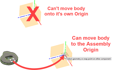

Hi @patrick_william
Thanks for posting the file. A couple thoughts.
  1. The reason that the Align and Move tools didn't work was because the second point needs to be on another component of the assembly Origin point as shown in the image.
  2. I edited the sketch that the SVG file was imported, but I was NOT able to move the imported SVG.
  3. I exported the this Sketch to a DXF file, then imported the DXF file. The I was able to move the geometry on the sketch as shown in the image.
    NOTE: Edited post. Instead of exporting the sketch as a DXF, you can unfix the geometry. The next post lists the steps.
    Hope this helps.

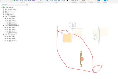

Wonderful!!! So how did you export the sketch? did you select all the sketch from the time line? and if so went to FILE/EXPORT/ or ??? not sure the procedure to do this.... can you help further.  This is all new to me.
William
Message 29 of 45
patrick_william
Holy Smoke!!! that worked for 2 of them.  man getting closer. now when I click on the "comRAN1" component to put it in sketch edit..... IT DISappears
Message 30 of 45
patrick_william
then it is gone???

Thank you Dan for all your effort, much appreciated. ComRAIN1 has 2 sketches for some unknown reason. The eye is on could this be why it disappears? Also ComclearC1 's origin is docked over the main origin. How do I move it off the main origin.  thank you so much.

Ok one more and I think I will be all set on this chain. ComclearC1 was miss moved by me to the Mother Component origin (partsv4)  by mistake. I want to have ComclearC1 to be the same as the other separate components ( Comnote, Comstar, ComRain) to have its own origin. and then there will be the origin of the whole group, which is good as well. How do I pull Comclear1 off (partsv4)'s origin and set up Comclear1 own origin?
