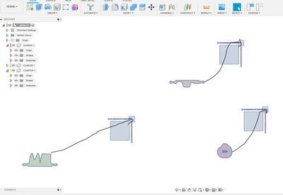

patrick_william
here is the screen shot. not sure why the others did not come in correct
Message 11 of 45
patrick_william
this doument will have all the parts of the sculpture.  If I choose "partsv1" ( the top tier) wouldn't all the parts be then at one origin? I wanting each component to keep its separate origin like they are now, but move the origin to the component floating in space connecting them

patrick_william
The images are imported as an svg file. my path was /Create "new component/ Insert SVG/ finish sketch/. The component has a sketch and a body and an origin.  The origin as in the previous photo came in not on the sketch as the one you showed. I want to pull the component ( all of it... its sketch and body) to its personal origin with a point on the Component.  As stated, it will not allow me to select the second point ( the origin) when I try to align them.  it will not let me move the component over the origin either. I can select a point on the component object to move the component to the origin but when hovering over the origin to make second selection nothing happens

patrick_william
this is what it looks like when trying to select the second point to align ( the origin ) is not hovering a point to select. planes do not work either as a selection
