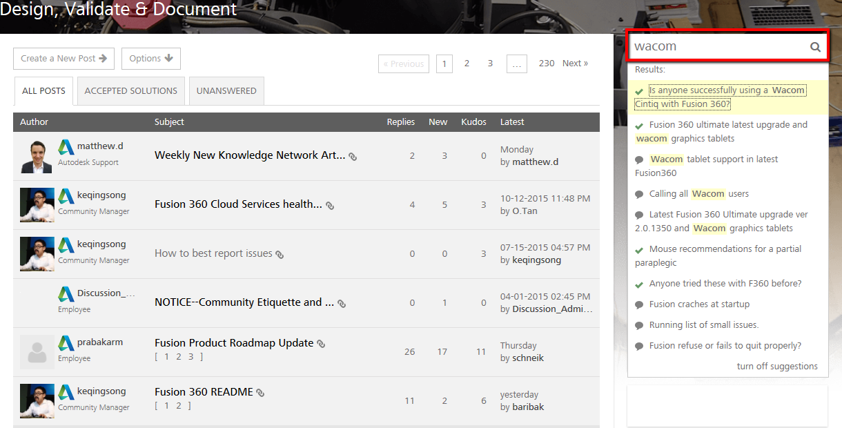

You can search for solutions using the community search tool:
Wacom is not enabled in preferences by default. So first turn it on.
