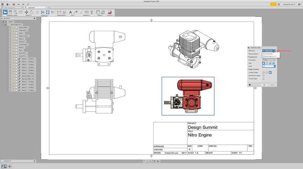

Hi @rapiddsol,
Sorry to hear your having trouble laying out your drawing sheets. The good news is, Drawings do support the workflow your attempting.
When creating base views, there are 2 options; you can either create a new reference to the model, or you can re-use an existing reference. Creating a new reference allows the associated base view and its child views to remain isolated from changes made to other references within the drawing. Re-using an existing reference allows multiple base views and their child views to remain in sync when changing are made to the reference. So when creating your second and subsequent base views, make sure Reference = Create New within the DRAWING VIEWS dialog.
Once you've created the base view and all required child views, suppressing or hiding components and bodies within the browser will only update the base view and its child views. All other references and their associated base views and child views will remain un-changed. And although I've shown this in a single sheet, the same applies across multiple sheets as well.
And here's a couple of tips to help you figure out whats what. First tip, each new reference within the browser is suffixed by a number; the first reference should be ":1", the second ":2", the third ":3" and so on. If you find multiple references using the same number, it means you've re-used the reference. Second tip, if you select the reference within the browser, all drawing views (base, projected, section and detail) associated to the reference within the current sheet will highlight. This will help you identify which drawing views will update when you suppress or hide components within a reference. However, if you've re-used the selected reference on another sheet, there is no feedback. You'll need to use tip 1 to identify any re-use.
And the third tip, when launching the Base View command from the toolbar, the command creates a new reference by default. However, when launching the Base View command from a reference's right-click menu in the browser, the command re-uses the selected reference.
Hope this helps, but do let me know if this hasn't solved the issue.
