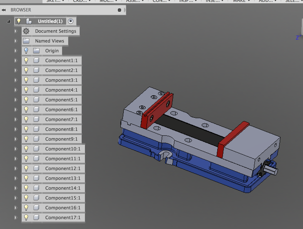

Good morning,
I am starting a machining project where I will place the part into a vice to program around it. However, the jaw on the vice will not move or should I say, not flexible. How do I fix/modify that? I know how to do in InventorHSM but I need this for Fusion. Thank you for any help I receive on this.

davebYYPCU
Short answer is to assemble it on the base with Slider Joint.

jeff_strater
@cmmpro1, if you are willing to share your design here, it will be much easier to describe a joint scheme that will work for your design.

jeff_strater
Thanks for the design, @cmmpro1.  I'll try to take a crack at this today.  The first thing I noticed is that your design contains only bodies, no components.  You need components to make joints.  So, the very first step is to use the "Create Components From Bodies" command:

Then, we can define the joints for this model, between components:

Here is how I would go about the joints for this model.  The basic idea is:
  1. Create Components from Bodies
  2. Capture Design History (so that you can use As-Built Joints)
  3. Define Rigid Groups for a few subsets of the components that move together
  4. Ground the base component
  5. Define a Slider joint for the jaw that moves
  6. Define a Revolute joint for the shaft
  7. Create a Motion Link between the Slider and the the Revolute joints
Finished model is attached.   Here is a screencast:
Hope this helps you make progress
