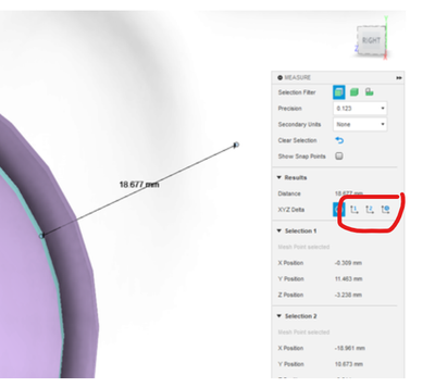

If you look at the below image it is a ball and socket joint. I am trying to measure the distance of the ball to the socket (the tolerence) to get a nice snug fit. As you can see, when I used the tool it picked a point which was was behind the right side point (when the view was aligned), then when I rotated my view I got the view you see above. I cannot change the mesh, I bought it online and it's been imported so I have to make do with this limitation.
I have found this happens a lot with imported meshes as there are so many points on the model and it doesn't seem to be smart about how it selects them - it just picks whatever point is closest to the cursor even if that point is far off in the distance.
Important: the image you see above is from using the cross section analysis tool. Is there anyway to tell Fusion to show a "slice" (from both sides) of that cross section rather than it being sliced and showing the whole back end of the 3d model?
Here is what I tried whilst using the cross section tool:
  • Keep it as a mesh - it still selects points behind.
  • Convert to solid - same issue
  • view in Wireframe and other views to try to select the exact points - same issue
I would have thought that when using a section analsis tool, that Fusion would be smart enough to know that when measuring, you only want to select points in that plane. Surely you can do this??

if the measurement aligns with one of the ordinate planes use one of these-
graham_S_allen
Thank you. I found that afterwards and it does work as you say. Luckily for me the object does. But what happens if I have an object that doesn't, do you know any other way I might achieve this when the object does not line up with the plane?
