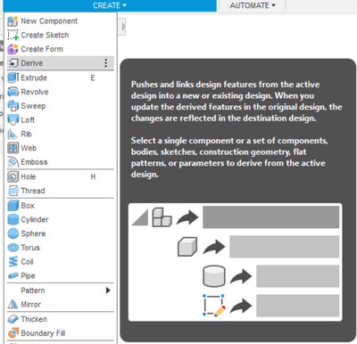

This sounds exactly like Derived Component (not Configurations) to me?  At least how Derived Components work in other CAD software - I have not used in Fusion 360.

I just tried Derived Component and it works exactly like described in your problem description.
Any edits to the base source propagate through all Derived Components.
Changes to the Derived Components have no effect on the base source.
So easy. So logical.

You're right! This is exactly what I needed and I don't know how I missed this function.
You're a lifesaver, thank you.
