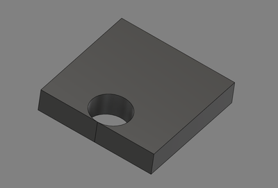

I would like to report a bug, and discuss about it.
I came across this bug after I've read this thread:
http://forums.autodesk.com/t5/design-validate-document/how-to-get-rid-of-this-error/td-p/6251046
Error described by @Anonymous is pretty basic, on first sight it looks like self-intersecting body... simple.
@NicolasXu advise seems to be ok, adjust form until you remove self-intersection... But what if it's intended?
Some of you should be able to recall design of an iron, that was used in Fusion youtube tutorials.
What if I would like to extend a hadle of that iron, like this:
That what I thougth, when I saw @Anonymous question, that his design was intendend.
My second thought was about, what if self-intersecting body creates closed volume? Maybe Boundary Fill could work?
To avoid auto-conversion, I knew that I need to go to Direct Modeling mode... I've sculpt an iron, then I've used Boundary Fill tool...
And impossible have happened self-intersecting solid appeared!
I was rather expecting to get just bounding volume.
Let's take a look at Uroborus:
I was even able to shell it!!!
Why I didn't report that to support, and made that thread instead?
Because it might be very useful tool, for designing jewellery or organic ornaments.
For now it requires some additional steps but it's possible, and while it may not be any help in @Anonymous case, it's worth trying.

Phil you still missing my point, I'm aware that we can make transition, and keep the shape... but it comes with price...
First, for quality surface you need to find right topology for transition. Second, complex faces layout is less manageable.
But what's most important t-spline workflow is streamlined, and it tooks a lot of work to make changes after all details are added.
I'm sure you will understand what I mean after you'll try to beat me (yes, small challenge among friends).
Below you'll find my screencast and uroborus model in attachments.
First, try to remove self-intersections (jaw & tail, and one in the middle) by adding some t-spline faces (maybe bridge command? whatever).
On second step, using the same body with all transitions in t-splines, make some "big" changes to the main shape (like I did in screencast).
My screencast last 3 minutes, to create any decent transition in crossing places, I would need much, much more time.
Because self-intersecting closed t-spline body also creates closed volume, I thought that we can use boundary fill to get non self-intersecting brep body...
As it turned out, not without another workaround.
All above is just small misunderstandment, we went in to (maybe because of my english?).
What is really important, is a bug. I was able to create self-intersecting solid body!!!
Even more it's possible not only with t-splines, but also with self-intersecting surface and Boundary Fill... more to come, Thicken tool also could do that:
Thank you for your attention, and have a nice day.

First, thanks for your post, I had not used the boundary fill before, but I see now its usefulness to convert a self-intersecting T-spline body into a solid.
I made a screencast basically following the same steps you showed in your first post.
It does raise a couple questions:
1. you get an error when attemping to Convert the t-spline body to a solid due to self-intersection. The question is, if the boundary fill can do it why not the Convert function? (albeit, should still come with a warning message that self-intersection has occurred).
2. since the convert doesn't work, we simply use the boundary fill, but wait, now there's that self-interection in solid form. What is the point of that? Why not have it fill in automatically instead of having to take a few more steps to split the body and recombine it?
Message 11 of 12
michallach81
1. Because developers, did overlooked? I mean that they allow Boundary Fill to succeed with creating self-intersecting solid.
2. and that's why I've posted that thread, that if developers gonna come with solution let it be a solution for finding that doubled volume and taking that in to account.
