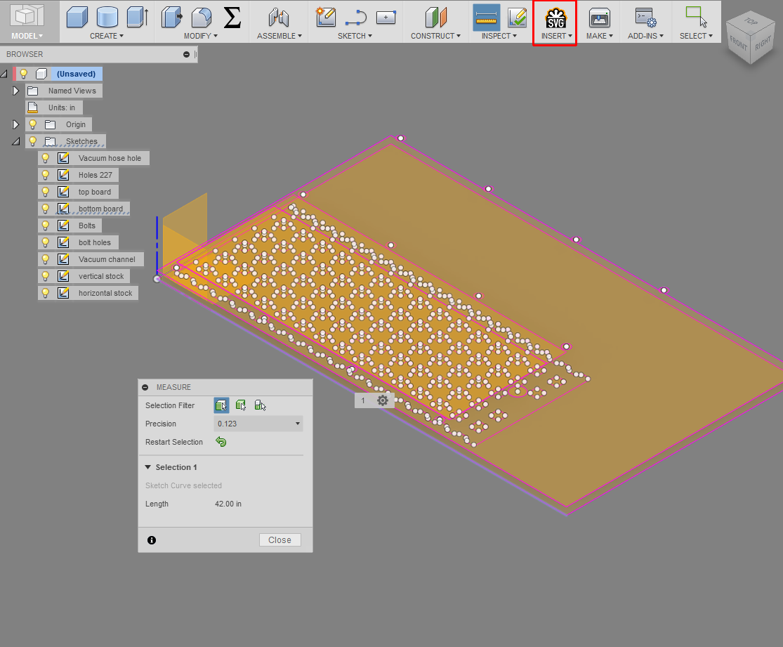

HughesTooling
Have you seen the update today, they've added Insert DXF to the Insert menu. I just gave it a try with one of the Rhino DXF file and selected One Sketch Per Layer and got this, correct scale and alignment.
I'll take a look at the Moi file latter and see if I can come up with any suggestions. One thing that might cause you problems is some of the sketches are above the sketch plane, you might find it easier to have all you sketched at Z0.0 in Moi\Rhino then move to the correct Z height after import.

I just uploaded the update and yes now one can just insert a dxf file in a sketch no problem. Except now all the layers are combine into a single sketch in front of your eyes. At least we can still use the workflow I suggested in post #20 and keep all layers translated into individual named sketch.
If I may suggest, that in the next update adding an option to keep or not each individual layers if any of course.

HughesTooling
Did you see this option on the import dialog.  One Sketch Per Layer
Mark

HughesTooling
Although Rhino opens the Moi file it would no be a lot of use in Fusion, all the arcs in the polycurves have been interpolated in short lines. The highlighted curve in this image is made from 16008 line segments, does Moi have any options for how it exports curves and polycurves, it might work better if you explode all the polycurves before export. One tip if you go through Rhino is to run simplify before the export.
