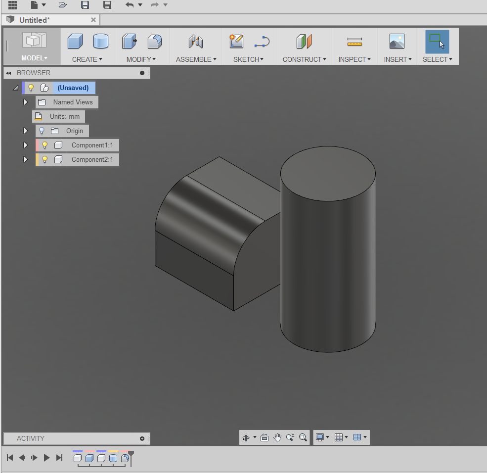

2. Movement during edit.  Jesse answered this (thanks, Jesse!), but I can provide some more context.  This one is sometimes tricky for people to get, because Fusion works differently than some CAD tools.  In Fusion, the assembly itself is history-based (not just parts, as is the case in Inventor and Solidworks).  We think that there is a lot of power in this paradigm, but it does take a bit of a mindset shift.  Operations like creating a component, adding a new instance, or move all are captured in history.  So, when you edit an earlier feature, sometimes things can shift, because Fusion rolls back in history to the point of that feature.  Here is a very simple example:
This design has 2 components, and I added a fillet to one of the components:
Then, I move Component2:
The Snapshot UI in the toolbar indicates that some components have moved.  If I click on that, I get a snapshot feature in the timeline:
Then, if I edit the fillet, Fusion rolls to that point in history, which temporarily undoes the move:
And, once you OK the edit, the components will go back to their positions.
